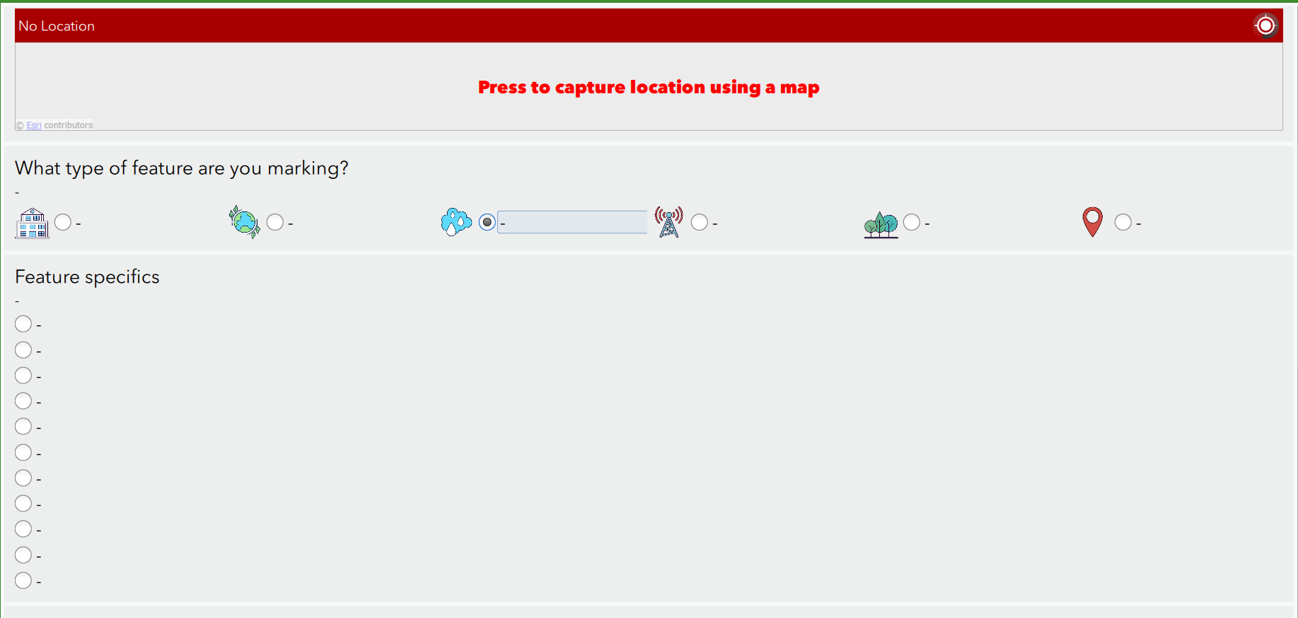

I am trying to add media image icons to make the survey form more comprehensible and appealing for community mapping. Everything was find until I wanted to add some images as icons for the values of my 'select_one' question. When I try to do so, my 'hint' configuration and choice values disappear and replaced by dashes. Please refer to the screenshot below.

I see that as soon as you add any image tag to the choices it does turn all hints and labels to just a -.
It has something to do with the second language.  If I remove the second language column and change the column heading back to just the word label then everything works fine.

Sorry for the late reply. But I found out what was the issue and I think it was quite careless of me to overlook it. Actually, the default language of the survey has to be configured in the 'settings' worksheet of the XLSForm. Do refer to the screenshot below:
After I have configured the default language, everything is right as rain.
