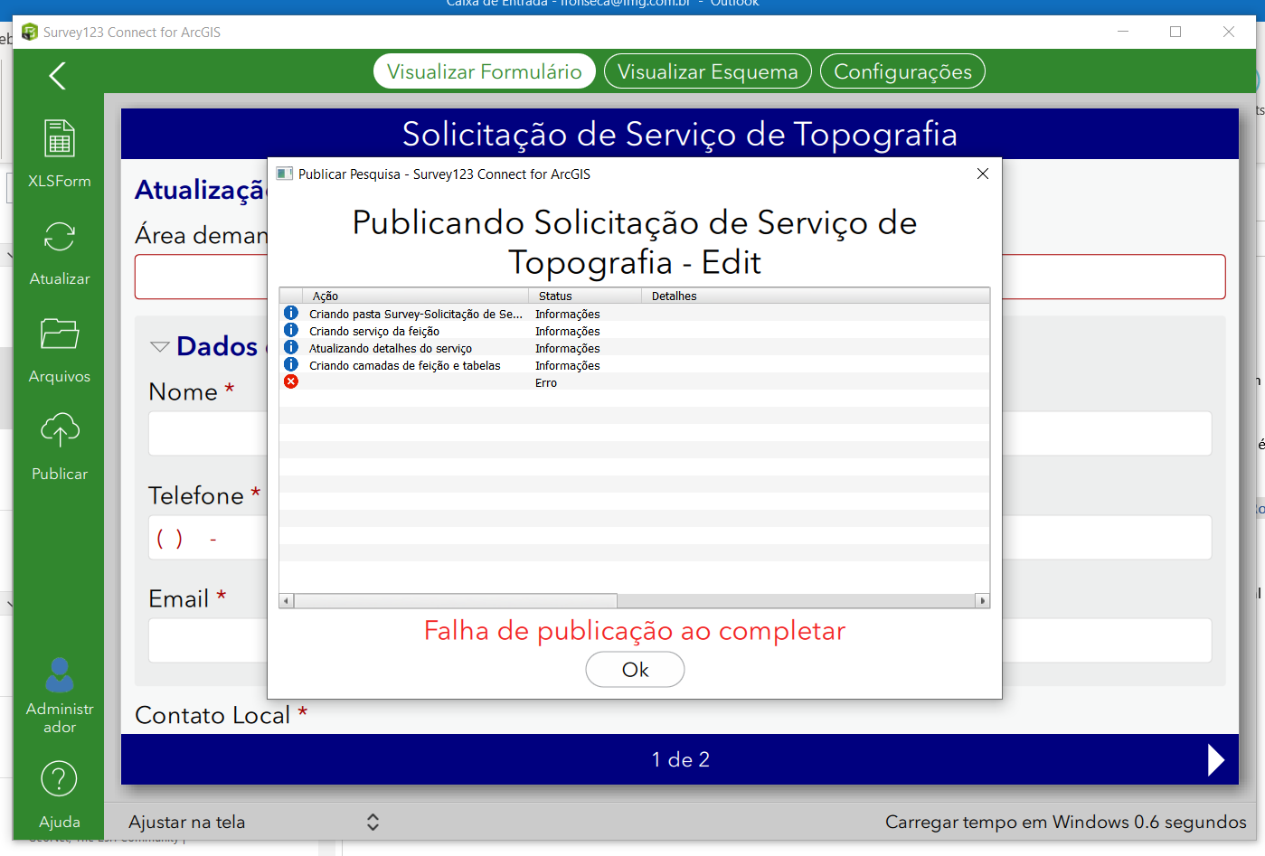

I am trying to publish a XLSForm in Survey123 Connect containing the Geoshape field inside a portal, but it is not working. I receive a message of error without a number or specification about it. Could you help me? Thanks!

Just to confirm, you are using Survey123 Connect version 3.6, correct?  Can you provide a screenshot of the error message, even if it is uninformative?  What version of ArcGIS Enterprise are you using?

Thank you very much for your answer. I am using the Survey123 Connect, version 3.6. The Enterprise version is 3.6.1. When I published the same XLSForm using my personal account it worked, however, when I tried to publish it inside a portal using the administrator login I got an error message.

Thanks for the details. It would be helpful if you could record a log of the publishing attempt - see Troubleshoot—Survey123 for ArcGIS | Documentation  .  You can log to a text file without connecting to a console.
