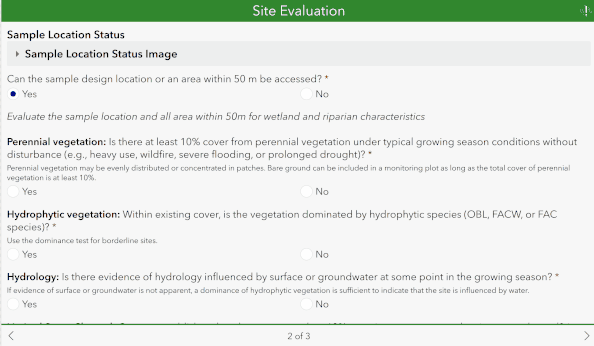

If it helps I have been using groups for help images that works pretty good. Can collapse or expand.

Anyway, can you give me an example of what are you saying ; "I have been using groups for help images..."
Are you saying to do a begin group/end group with images??
My goal is having a  thumbnail of the image or a small size that can be expanded.
Thank you
DougBrowning
MVP Esteemed Contributor
Sorry I meant to add a gif but all our files are moving and could not get to it.  Here is a new one.
