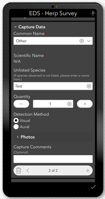

I just tried it with the suggested change and it works as expected. See below.
The only other change I made was removing the required setting from row 32 (it refers to an external table that you didn't provide).
Try making the same change sat your end and letting us know how you go.

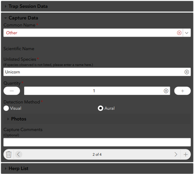

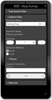

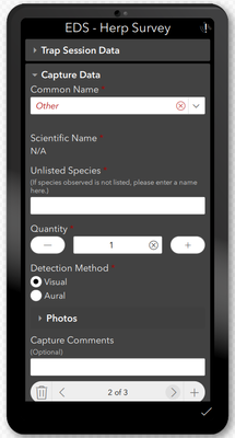

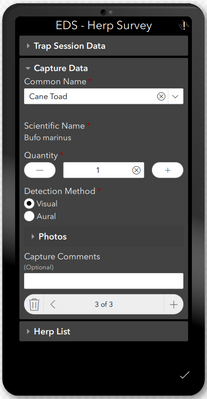

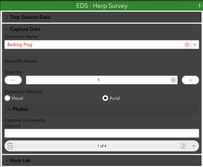

EDIT: See images below. I wonder if it's a version issue or something? I built this survey in January 2020 and it's been running with no issues until this, maybe something happened with a recent update? I'm running Connect version 3.14.256, if that matters.
