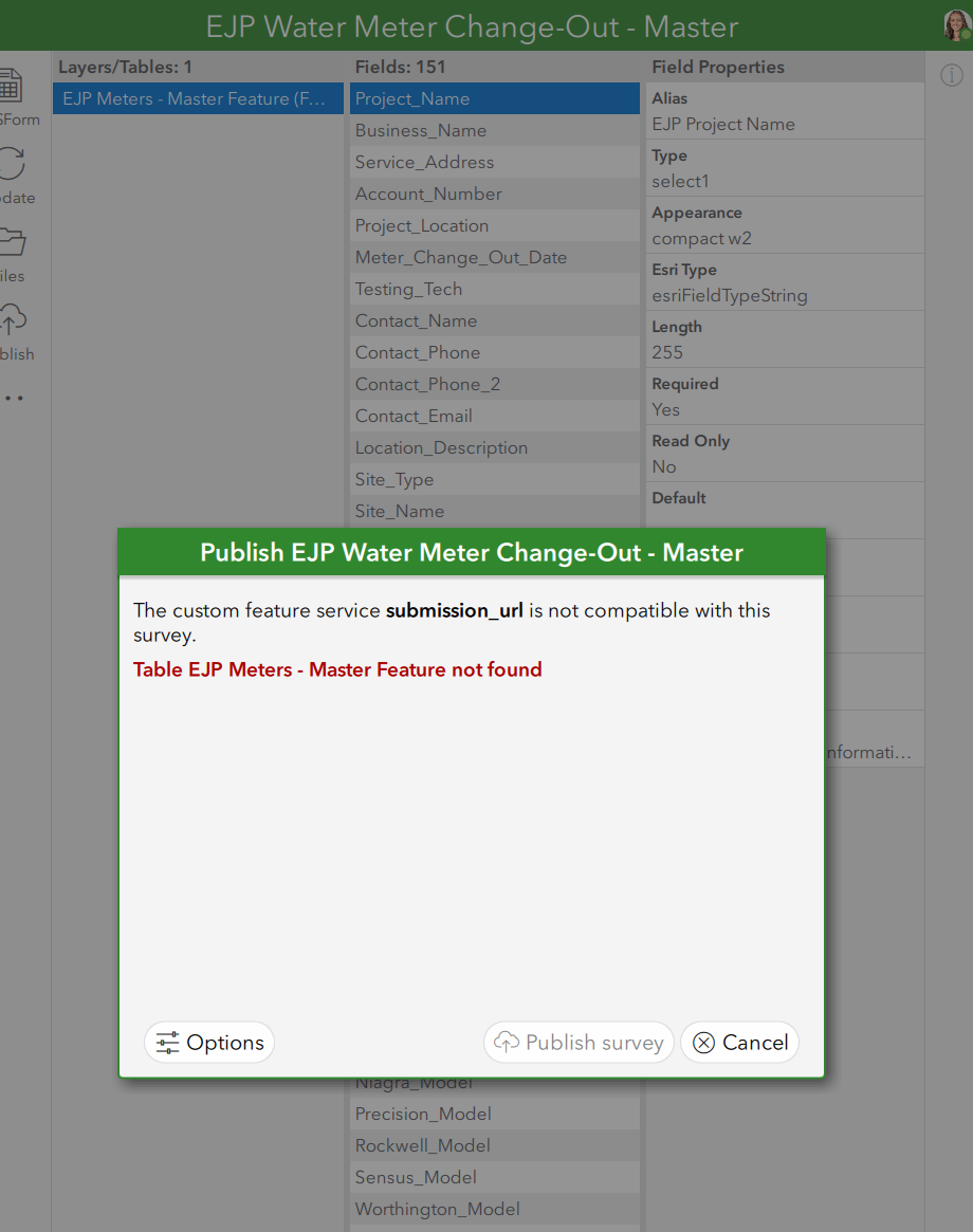

Hello, I created this survey from a feature service. It was working and i was able to publish it. I just checked on it and now im getting this error
I double checked to make sure this feature still exist and the Item ID in the submission url matches the Item ID of the feature i created the survey off of so what could cause this?

The error in the screen capture is referring to a table but it looks like from the schema in Connect EJP Meters - Master Feature is being reported as a Feature layer.
Is it possible that the layer in your submission_url feature service is a table instead of a feature layer? If the layer is a feature layer do you have a geo* question in your survey that is set to null in the bind::esri:fieldType column?
