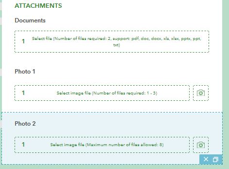

here is my design survey to attach photos/images.

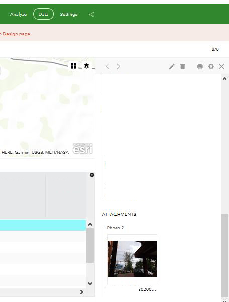

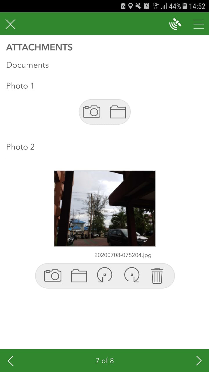

When i use 123app, the survey cannot take more than 2 images
It would be recorded in data and upload maximum only 2 photos

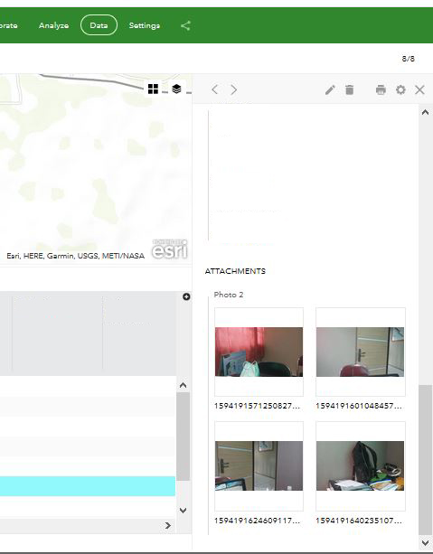

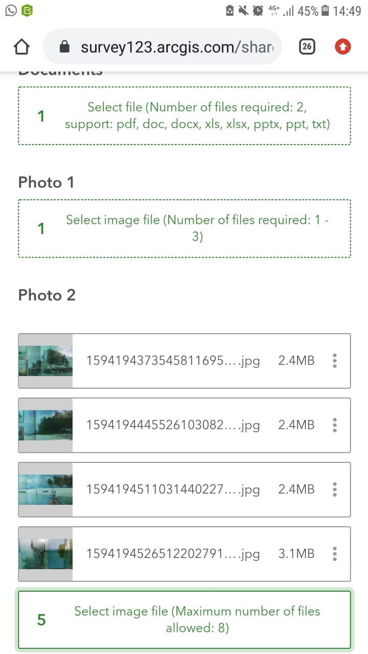

However using web browser its still possible, can be shown as the image below..
The uploaded data also record all photos
Using browser still possible. however in areas which has no internet connection needs survey123app to do some tasks.

This is expected, as the 3.9 release does not support multiple images or files for the one image or file question type. This will be supported in the 3.10 release which is due to be available in the coming weeks. If you want to test out this new functionality earlier in the field app, I suggest you take a look at the Early Adopter Community and the 3.10 RC builds where you can test this out.
If you want to find out more you can also read the documentation on EAC here.
