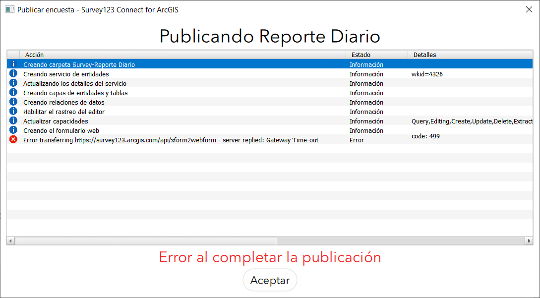

Error al transferir https://survey123.arcgis.com/api/xls2xform - el servidor respondió: Error de proxy

Hi Brigitte,
Apologies for the delay.  This can occur if you have a survey that has a large number of choice lists.  One way to work around that would be to use external selects if appropriate.
