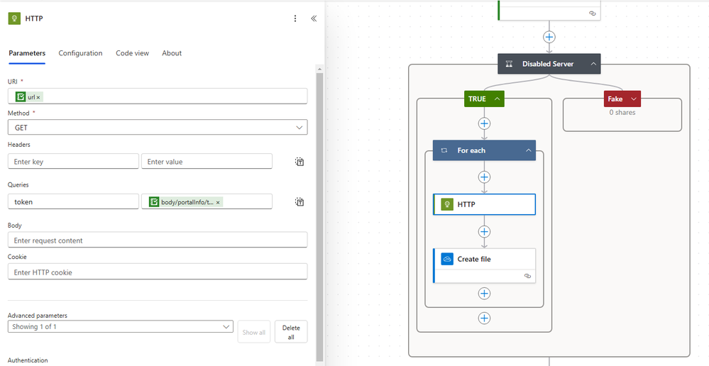

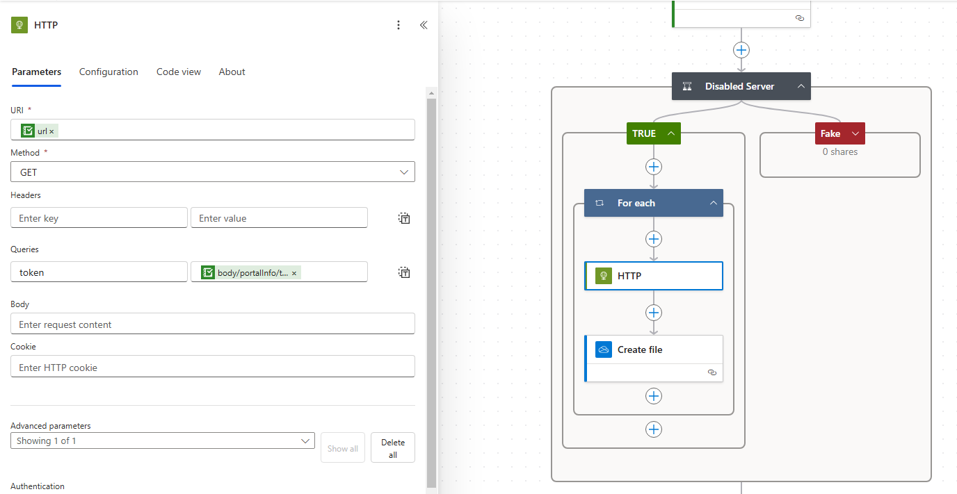

Hi everyone!, I've been trying to create a Power Automate's flow to get attached PDF's from a survey123 fom responses and send them to a OneDrive's folder, but I just can't get it to work, I'd be really grateful if someone who got through this before could tell me what to do.screenshot.png

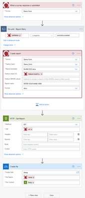

For the HTTP step, a token shouldn't be necessary (at least if you are using the new actions).

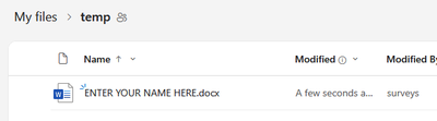

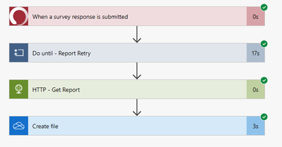

Here are the minimum steps required to save to OneDrive (technically the Do Until isn't mandatory, but I very highly recommend you add it as a minimum):

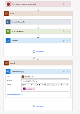

And because my anxiety goes up not seeing any error handling, here is a bonus:

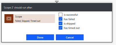

Using "Configure run after" (click the ellipses for Scope 2), have the second Scope trigger on an error. Example below:
All that is required of that email is you add this to the body (Use the "Expression" option, and paste this in). This will give you a direct link to the failed run:
concat(
    'https://emea.flow.microsoft.com/manage/environments/',
    workflow()['tags']['environmentName'],
    '/flows/',
    workflow()['name'],
    '/runs/',
    workflow()['run']['name']

DTH
Thank you so much for your reply but I already solved it, just needed to put a token along with the URL inside the HTTP action. I didn't know about that error handling function, it might be useful for me later. Again, I really appreciate your help.
