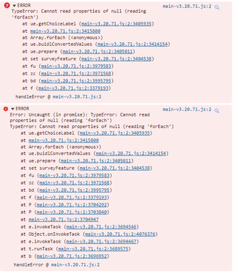

I have reached out to Esri Support (Canada) and sent them a HAR file, the XLSX for them to try as well, and did a call with them yesterday to show the error. The HAR apparently did not show anything while looking at the network data in the dev tools in Edge, but when we looked at the Console section it shows a couple errors.
This is just me speculating, but something about the "ForEach" being in the error makes me want to connect it to the repeats in my surveys, but of course I have no idea.
The error above is what I got looking this morning, yesterday one of the errors expanded and was very very long, but these ones are not.
