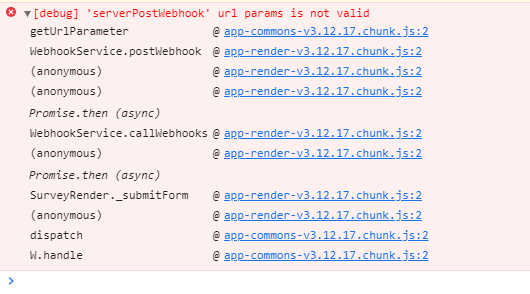

Hello,
I am getting some errors from Survey123 regarding the webhooks.   When I watch the Console in Chrome, it tells me that 'serverPostWebhook' url params is not valid.  When I inspect the elements called out in the Console, they all point back to https://survey123.arcgis.com/share/v3.12/app-commons-v3.12.17.chunk.js
Is this a problem with Survey123 or something on our side?  We are running ArcGIS Enterprise 10.7.1 and the survey is published in the latest 3.12 version.  Since sometime around 4/2/2021 I've found none of our forms have been sending Webhook payloads correctly.
MichaelBrown4
Looks like we see the error in Console, but everything is working correctly with our webhook.
Thanks!

Hi @MichaelBrown4 ,
Can you provide more information- where are your webhooks being sent to?  Do you have any errors in the responses of the network connections?
MichaelBrown4
It's going to a company webhook server we developed a while back.  It's been working great for sometime now.  I can send you the URL in a private message.  I don't see any other errors in the console in the Network section.
Thanks for the prompt response.  I'll try and provide any additional info you need!
Mike

MichaelBrown4
Thanks!
