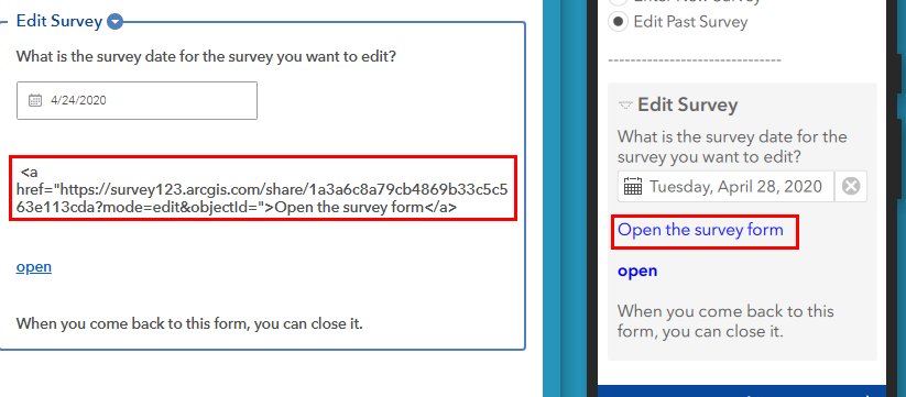

2. Hyperlink doesn't work in the webform. <a href="URL">text<a/> generate hyperlink in connect, but not in webform

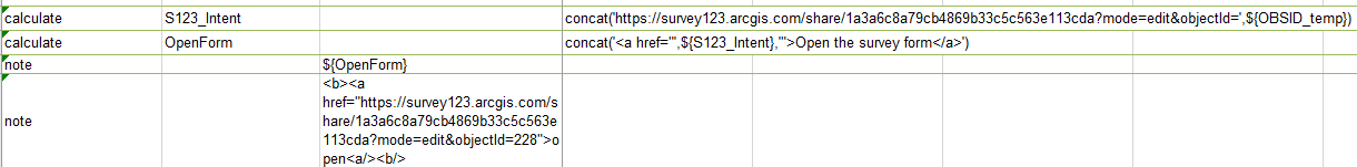

I made the hard copy of the hyperlink (second note), and it works on both connect and webform, but the one I made using concat - $(OpenForm) doesn't work in the webform.
In the image, the URL is not complete (no object ID) but even I get the object ID, the link is just a text, so I can't click. But in the connect, it becomes a hyperlink, so I can click it to jump to the form with the data.

And for the hyperlink, I played with the ' and ", and nothing works. The hard copy hyperlink is for that purpose. I switched ' and " and it actually both work. To create the hyperlink using concat, I had to use " for the <a ref> tag. Since the link is working in connect, I don't think the issue is the <a ref> tag. It's something with the webform.
