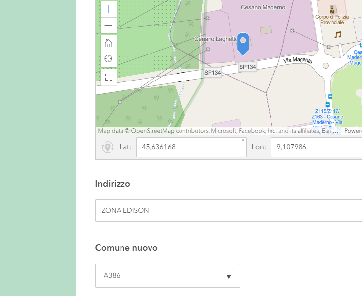

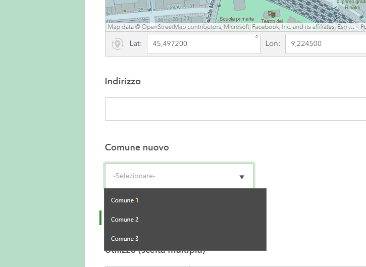

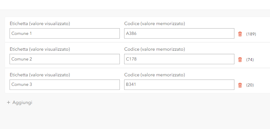

Hi all,
just to point out that in web version 3.18, for field with a coded domain associated...
and you have to edit an existing geometry with a web form, Domain is not honored
Instead if you insert a new point, Domain is honored.
Anyone else can confirm that?
Thank you
Stefano
