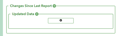

Ideally, I want the user to see the embedded survey with a repeat section that looks similar to this:
So far, I've only been able to set up the repeat to display this way for a new form submission and not editing an existing one by setting the appearance for the begin repeat to minimal.

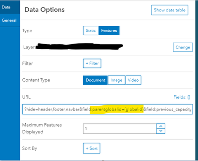

  7. Users are submitting updates through a dashboard where selecting a feature in a list element filters a survey in an embedded content element.  Since the feature service populated by the survey was recreated above, I had to recreate the list element in the dashboard to point to the new feature service.  My dashboard now contents two embedded content elements.  The first one points to the original survey with basic facility information, with URL parameters set to open the form in edit mode and hiding all of the questions in the repeat.  The second embedded content element points to the survey on top of the related table, but it is not in edit mode so that the users submit a new related record.  The URL parameters for this second embedded content element capture the globalid from the main feature service and set that equal to the parentglobalid in the related table: JoshGroeneveld_2-1612804674987.png

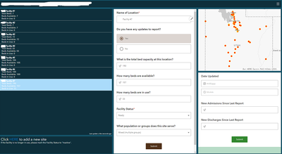

In the end, the final dashboard users see to submit their updates looks like this:

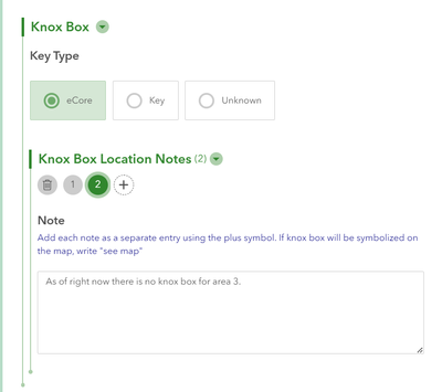

I'm looking to do something similar. I have users that will be submitting to a survey with two repeats. However, they may need to go back and add additional repeats after the survey is originally submitted. I don't mind the idea of just having a separate form that holds the repeat table, but will this workflow create a totally separate entry in the Survey123 hub? My users want to be able see the related forms in the S123 app so they can print off reports from one place:
