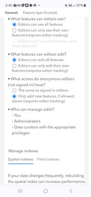

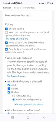

survey123_solutions
I was getting the same Send Error.
After trying to change settings in several areas, this is what worked!
Change the settings for the hosted feature layer to be this and it will work. Hope this helps.
PS I'm working with a hosted feature layer with a related table so my settings may need to be this way for that reason.
