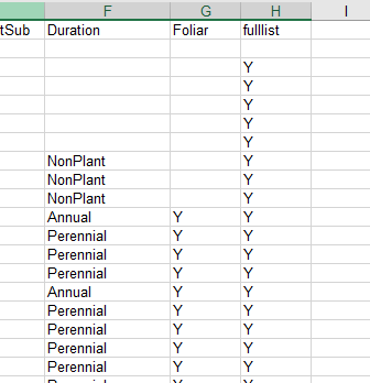

Create dummy fields to hold the text
Use these in you choice filter
Foliar=${fulllist} or Type=${none}
Have a column in external_choices that has the text from the fields
In this case fulllist is set to 'Y' then I give every item in the list Y.  So it is not actually filtering anything, it just gives me the full list, but I still get all the speed benefits of using an external list.
Hope that helps.
