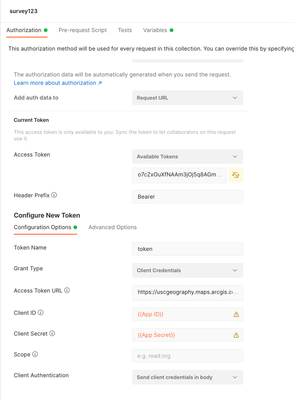

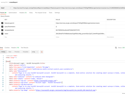

Maybe someone will answer if they see that I also tried in postman:
the above works to get my token. But then I do:
and it still asking me to "Sign in to your ArcGIS Survey123 account"

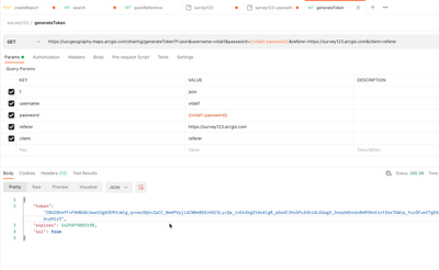

JoseVidal
I also tried login in with my useraneme+password, but the same thing happens. I can get the token, but the token does not work:

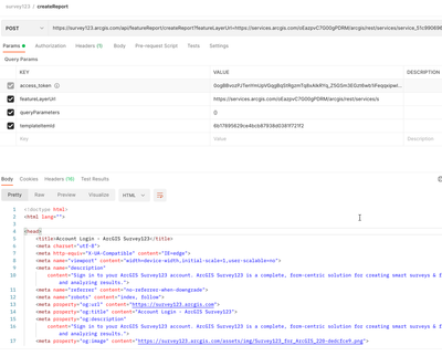

then I try to use the token:
EricKerneyASL
I believe you need to add the submitJob portion to the URL:
'http://survey123.arcgis.com/api/featureReport/createReport/submitJob'
