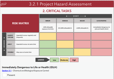

Side Question: I am using Survey123 Connect and building the form via Excel (XLS Form). Is it possible to add a table as a note to the form thru the XLS form?
abureaux
MVP Frequent Contributor
By 'add a table', do you mean like an image to help the user, like the below example?
If so, that is quite easy. Just add the image file to your media folder, and reference it like so:
Just be aware that the image is caps-sensitive. So be sure to copy-paste the full name (including file extension).
ModernElectric
Exactly
Yup, that is very easy.
