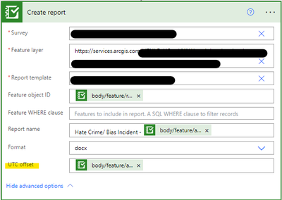

Here is my solution based on the US Eastern time zone.
1) In Survey123 Connect XLS add a text utcOffset field. Then insert the following into calculation field ---> if(pulldata("@property", 'utcOffset')='-4','-04',if(pulldata("@property", 'utcOffset')='-5','-05',pulldata("@property", 'utcOffset'))). Use "hidden" In the Appearance column.
2) In MS Power Automate under the Create Report step, place the newly created utcOffset feature attribute in the UTC offset field.
