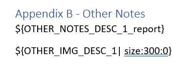

Hello,
I am having some troubles with my Survey123 dynamic report template. I am trying to create a template that has a series of multiple choice questions. In the survey I have the questions setup so that if you check my "Evaluated" box in the question, you get a comment box. If you check the "enforced" box you get no comment box. My problem is in my report template i cannot figure out how to writ the code to only display the comment box in the printed report if the "evaluated" box is checked. If its not checked I would like no box to show up in report print out.
I have attached a photo of my template, if anyone has any suggestions I wold appreciate it.
Thanks
Michael
10 Replies
JaredTaylor
Hi Michael,
I get around this by having a calculated field in the survey. I then use that field in the survey report template.
