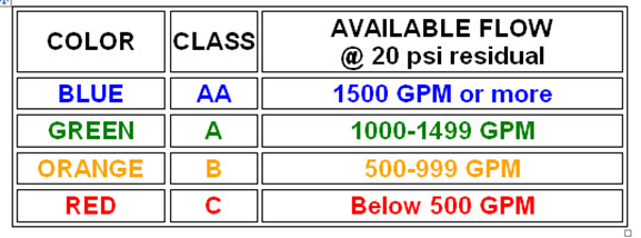

I am trying to put some conditional formatting in a Survey123 Report. I'd like to have a certain hydrant class show with color formatting for each report based on a flow in GPM in an integer field.
The formatting at both AA & C with just the >= or <= statements work for formatting, but I am having trouble with class A & B with the ranges. It doesn't appear to format the same way I am used to.
