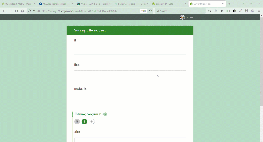

Hi, After the latest update there is a  problem in my Survey Form. When I want to calculate the data in feature layer to the related table, only the first record inherits the data, but not he other records. Please kindly find the sample in the attachment.

You are right. I can reproduce this problem. @UğurBaranSarıbaş
I will add a note in our internal development repo. However, it will be best for you to open an official Esri Tech Support incident so you can have a ticket to follow up.
As a workaround, you can force the web app to use the 3.13 version by adding ?version=3.13 to the url.

Hi @UğurBaranSarıbaş ,
Thanks for submitting the Technical Support incident. The issue you raised has been fixed on the current production environment.

Hi @IsmaelChivite,
Forcing web app to work in the previous version did the trick! Thank you. I'll be opening an Esri Technical Support incident for follow up.

Hi @Ruth_JiatengXu ,
Thanks for the notice. Updating to version 3.15 solved the problem.
