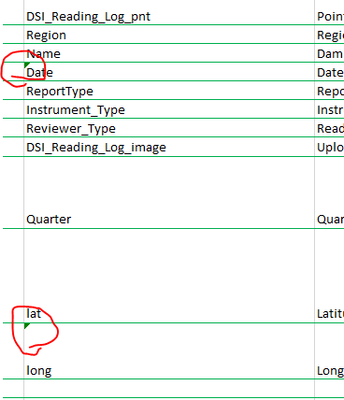

DougBrowning
MVP Esteemed Contributor
Both long and date are reserved words.  That is what the little green box and error message mean.  Cannot ignore these.  Portal has diff storage so that is prob what tipped it off.
You can see all the Reserved words on the last tab of the excel for the form.
Hope that does it.
JacobRothberger
Thank you for the quick reply, @DougBrowning .
I switched out long for longitude and Date for logDate. Still works in Connect and still returns the same error ( 'Failed to load data from https://arcportal-ucop-...'). ).  Do you have any other ideas on how to resolve this problem?
Jacob
