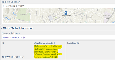

@ZacharySutherby ,
I downloaded the script and have it working with your data. Now, I am trying to replace parameters to work with my own data, but am getting an error. Here's a few images of what I'm getting.

Do you have any thoughts on why it's not finding f_id? I can't find find where else to define it in the script or the calculation?
BenBaker1
The issue I was having was a syntax error. I did not put f_id in brackets as ${f_id}. However, I did have further issues passing the parameter as text before the script worked. Since there are spaces in the address, I had to add additional quotes to the query line:
let where = "where=FULLADDR="+"'"+ID+"'";
