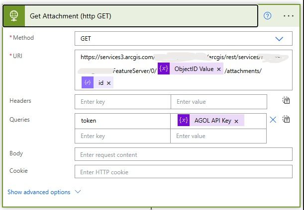

ArthurSmith2
We ran into this same issue and ended up generating an API key in AGOL to avoid using credentials in the flow at all or having to generate a token in Power Automate.  You can also configure the key to only have access to layers it needs, another security enhancement.
How to use an API key | Documentation | Esri Developer
