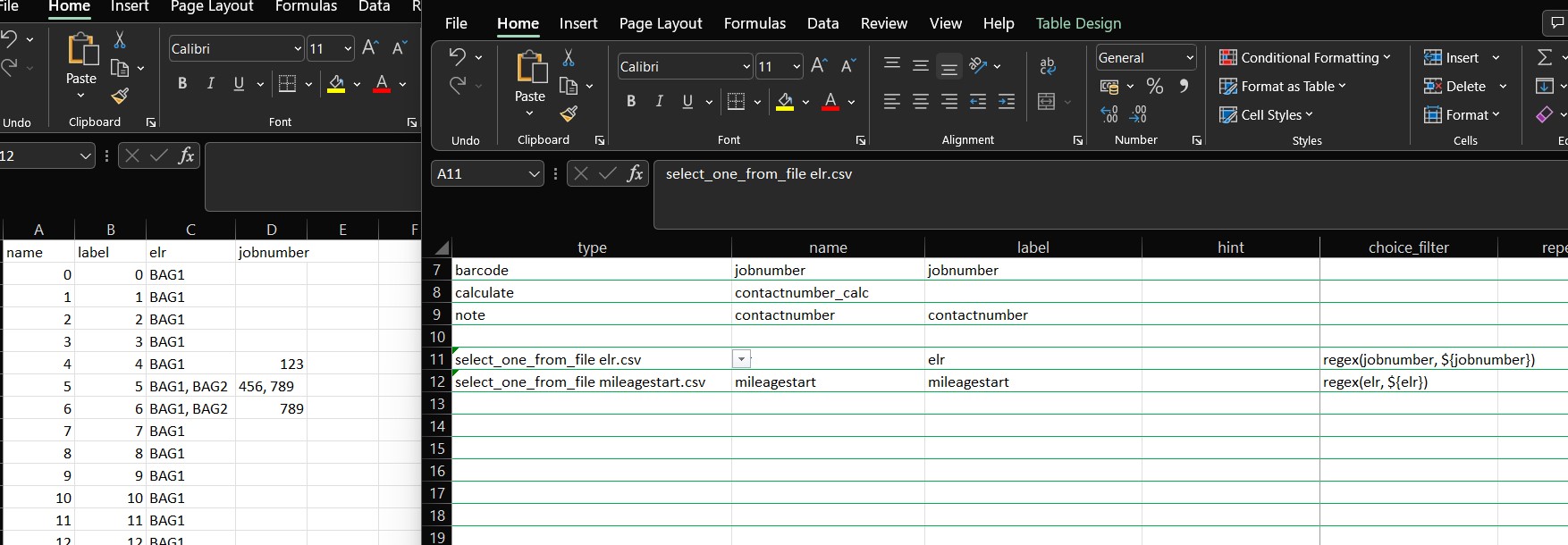

Hi,
Is it possible to retrive data from multiple columns in an external choice list?
I have few conditional cascading that I would like to be stored all in one external spreadsheet.
On the screenshot attached I have the external choice spreadsheet and on the right the survey that I am trying to build.
Is it possible to do multiple filtering in the same external spreadsheet? I don't find useful to build 4/5 spreadsheets.
Thank you
nabaz-gharib
do you want to retrieve data from multiple columns or filter list based on multiple columns?
for the last one, yes you can, on choice filter you can use and/or to filter the list based on multiple columns.
for the former question, I am not quite sure what do you mean? because you can retrieve multiple column by using multiple questions.
