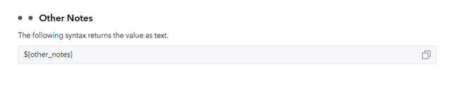

This is the screenshot from the syntax helper within the Survey123 website (notice no multiline appearance available):

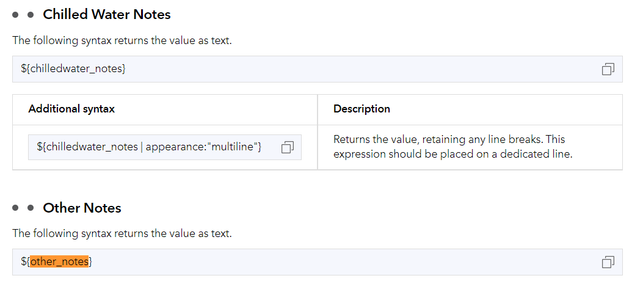

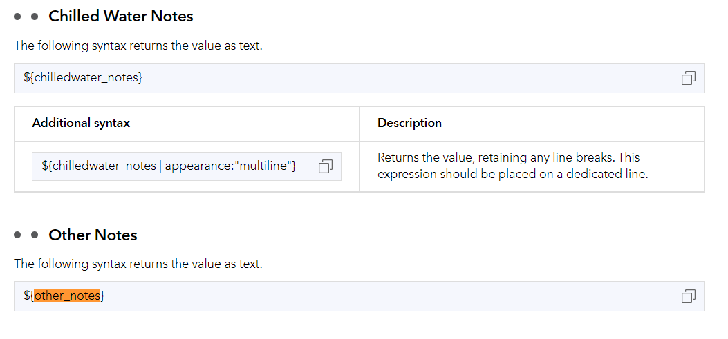

Here is a field from the same feature service, within the same group that works both in the survey form and in the feature report:
textchilledwater_notesChilled Water Notes
w4 multiline predictivetext
The only difference between these two fields are the names, they both have the exact same appearance and character limit. If anyone has any tips as to what could be causing this I'd very much appreciate the help!
