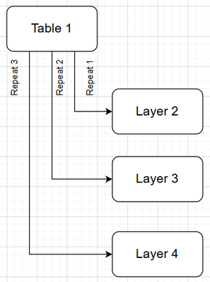

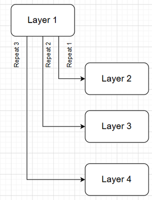

It sounds like you have a schema that look like this with repeats:
I usually define my schema in a File GDB first, publish that File GDB as a hosted feature service (with multiple layers & tables within it), then use Survey123 Connect to publish my form so it attaches to the existing service.  This is done using the Settings worksheet of the XLSX, using submission_url and form_id.
If you take this approach, you can create this schema instead:
Your top-level data will post to the table, and you won't get any points stored, but the geopoints within your repeats will behave normally.
