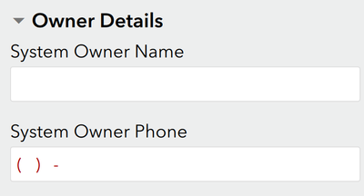

RutledgeNicholas
Is it possible to put (999) 999-9999 in the input mask column to use parenthesis for the area code instead of hyphens?
TristanSHiggins
Yes, you can use parentheses in the input mask, they'll appear as placeholders to indicate the formatting for the user as below:
