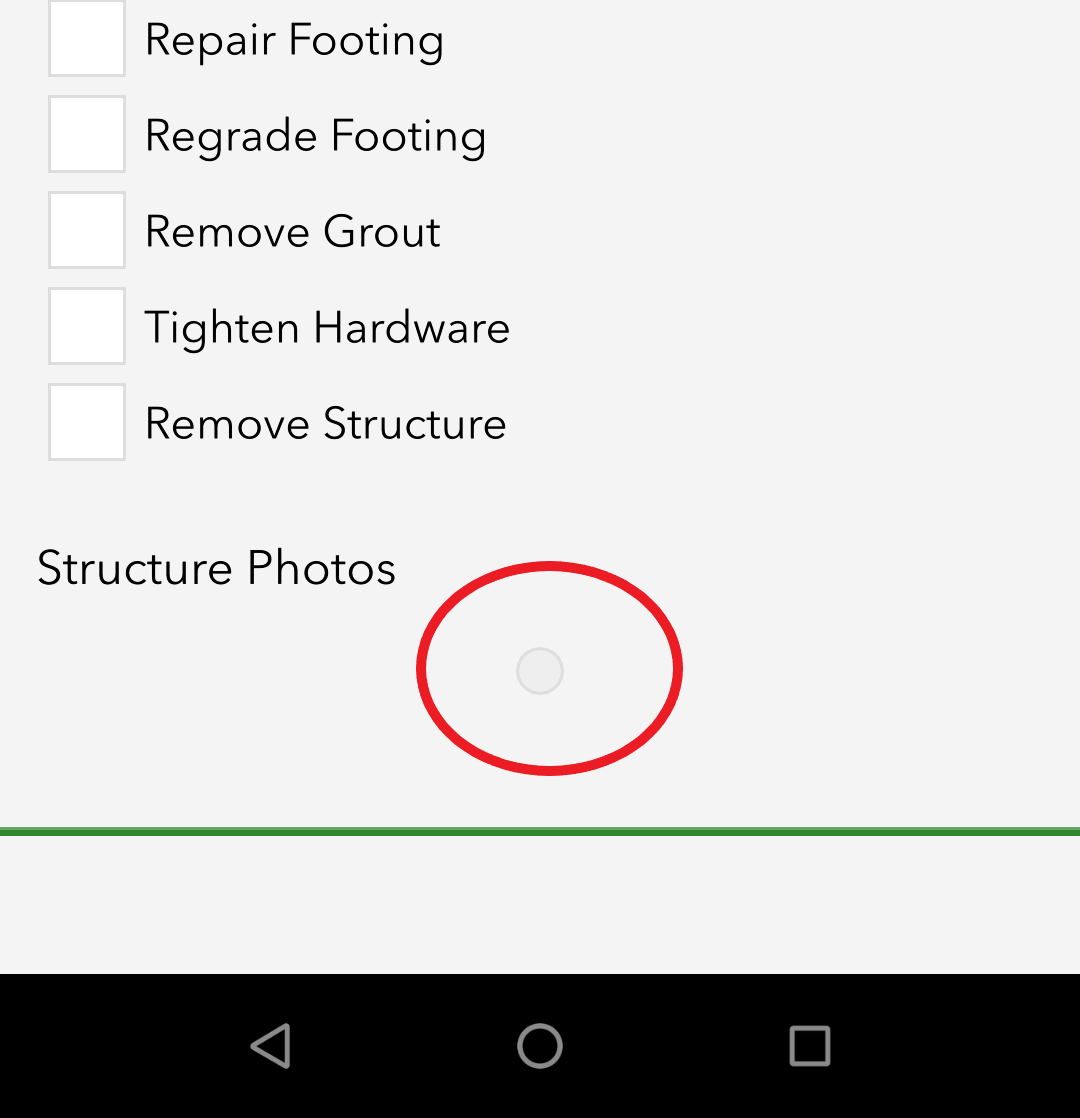

The first issue is that the multiline image attachment question in the inspection isn't showing up properly when the form is viewed via the field app (current Android version).  There's just a small grey dot where the UI should be:
image attachment not displaying
The image attachment does appear and work fine in the web form, however.

Update: my initial problem above can be disregarded; I just found other GeoNet posts that explain how photos can't be added to existing records when accessed via Survey123's Inbox function.  It would definitely be handy if they were, since our entire workflow for these inspections is based around being able to revisit and update existing records.
Relying on the Collector Web Map + URL linking to the inspection would work if our inspectors were able to successfully save or update inspections with photos attached; hopefully we'll be able to figure out why that hasn't been working.
For now it looks like our only option is to follow what another user suggested: taking photos in Collector (since our users are already using it as a work tracker and the Collector map features have a 1-to-1 relationship with the inspection records) and then figuring out how to integrate the photos and inspections into a single dataset later on.
