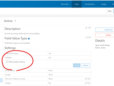

    3. If you're on AGOL (or you're reading this when a later version of Portal has this ability), make this attribute non-editable so that users cannot inadvertently edit this field, should the layer be opened outside of Survey123.

    3. Change the field settings on "Approved" to make it editable in this view. Note that it will tell you the properties are Overridden. That's what we want!jcarlson_0-1613482224955.png

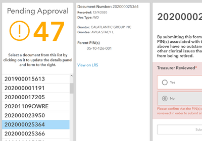

There are many ways to accomplish the final step. Our approving users wanted something very straightforward, so we brought the view layer into a dashboard list. Selection in the list filtered the Details element and the Embedded Content.
The embedded content is a very bare-bones Survey123 form, which only exposes the Approved field for change. We've been using this for over a year now, with virtually no issues. Hope it helps you!
