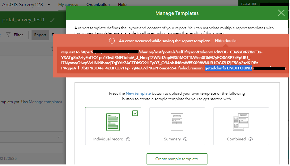

I am doing the same thing now. I have created a Hosted feature service on portal and by using this have created a survey in Survey123. When I am trying to print the report by using the custom report for the existing record in hosted feature service I am getting Error as getaddrinfo ENOTFOUND. I can't even export the Survey123 default template. Any suggestion on these please? Have we fixed this issue with new Enterprise version?
I am using 10.6 Portal.

Actually, the error getaddrinfo ENOTFOUND is expected if you are using a portal which is not public on the internet. This is because the server of the feature report engine cannot access the item/data inside your portal.
Also, please be advised when the feature report moving out of Beta, it will not support surveys in ArcGIS Enterprise anymore due to ArcGIS Online credits will be charged.

For now, you need to expose your portal to the internet to solve the issue (can open your portal's home page from any computer in the world). In the future, there's no way to create a report for surveys in ArcGIS Enterprise.

Is there any update on getaddrinfo ENOTFOUND
"Printing using feature report templates does not work with ArcGIS Enterprise deployments that aren't public facing. Attempting to do so will present a getaddrinfo ENOTFOUND error."
Please advise, how to overcome this issue.
