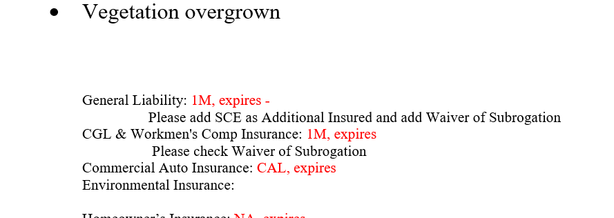

I have a survey with a repeat, and when I print
${#Inspection}
${OperationalConditions2| appearance:"bullets"}
${/Inspection}
The bullets are always a consistent large size, and I can't seem to fix them.
I've tried different variations of HTML with no success
${#Inspection}
<p style="font-size:8px;">
</p>
${/Inspection}

Thank you, James, normally the Word font would work, but inside a repeat, I can't get the font to change size.
The workaround is to go into the finished feature report and change it there, but I don't want to do this for every report.
Please Help!!!
