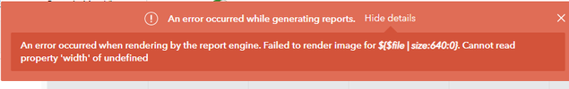

Survey123 feature report error Cannot read property 'width' of undefined
5393
8
05-06-2022 06:02 AM
RobBlash
I have a survey with ~15 daily users. Most submissions have no issues, but there is one user whose forms randomly cause this error when generating a feature report. My work-around is to download each photo, screen shot it, and replace the attachment with the screen shot. Once that's done I can export the PDF. Obviously, this is less than ideal.

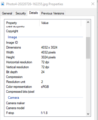

I've inspected the EXIF data for many of these photos and cannot find what the problem is. This person is using a samsungSM-S908U device, most others are using some version of iOS or a windows surface. That's the onlynotable difference I can find.
Anyone else with this issue?

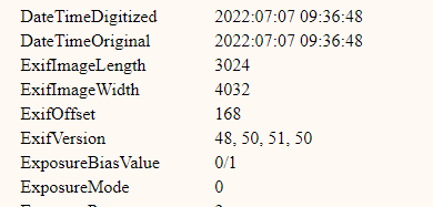

I did look at the EXIF data further (exporting the full data using EXIF tool) and found that the offending photos are typically missing these EXIF params: : ExposureMode, FlashpixVersion, OffsetTime, OffsetTimeOriginal, SceneType, SensingMethod. My guess is the time ones are causing a problem, but I hit a snap trying to fix the EXIF and gave up.
So, if I have a bunch of photos I export them all, chekc ther EXIF data, and can narrow down which need attention to create the report. Hopefully this can be fixed sooner than later!

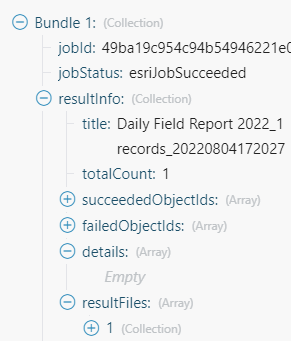

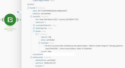

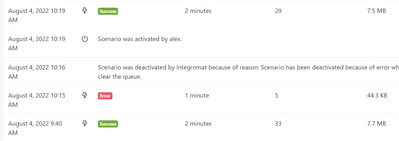

I have about 10-20 surveys going through Integromat/Make a day now.  This error (on established surveys and feature report templates that haven't changed in months) is one of the ~10 errors that pops up regularly that's always fixed by re-running the report generation.  If it's not resolved, I'll wait 20 minutes and run it again.
I know that's not exactly a "solution", but I'm just trying to point out that it might be a server side issue that will self resolve.  I added a sleep module between the webhook and report generation hoping the issue would resolve, but that doesn't seem to have changed anything either.
Long story short - make sure it's not a server side issue before you spend 3 days troubleshooting.
Failed -
The 10:15 run that threw an error is the screenshot above.
10:19 was after restarting the scenario.  No changes to report template, feature service, survey submission, etc.
successful

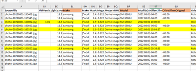

@DougBrowning try extracting the full EXIF data from the offending photo using EXIF tool: place the photos in a folder with exiftool.exe and run this command throuhg a batch file:
exiftool -CSV *.jpg > PhotoExif.csv
That will dump the full EXIF data to a csv file. I've noticed that the offending photos are missing several EXIF attributes. I've been using "OffsetTimeOriginal" missing as the barometer for which images are causing the issue, and running the screen shot work-around on those has been successful.

I am experiencing a similar issue.  I'm on a Samsung S21+.  In the last month or so, I have been getting error about "Cannot read property 'width' of undefined".  It is random.  Some photos cause report creation errors, some do not.  Examining the EXIF data it appears, as other replies mention, there are fields 'OffsetTime' and 'OffsetTimeOriginal' missing.  This must throw off the expected parsing position of 'width' exif parameter.  And why the error message reads as such.
I spent a most of a day troubleshooting.  It appears the creation of the 2 'OffsetTime' parameters is random when the photo is taken within Survey123.  Sometimes it is part of the EXIF that is uploaded to the survey.  Sometimes not.  When it's not in the photo, that photo stops report from being created.  However, I discovered that when taking photos with the default camera app, the 'OffsetTime' parameters are always there.  So something is happening with the Samsung camera and Survey123 in the background.  I believe this happened in the last 1 or 2 updates to Survey123.
