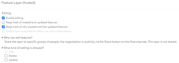

If I go on the 'Collaborate' setting for the survey and check the box 'Only add new records' for 'What can submitters do?', the page saves successfully but when I navigate away and back it is unchecked. It is similar to this issue but because I used Connect I do not have a '_fieldworker' layer so can't use this fix .
These are my setting in the hosted feature layer. As you can see the 'Add' is greyed out for 'what kind of editing is allowed'.
Does anyone have any tips? It seems using the fix to protect the data has somehow broken the submission process.

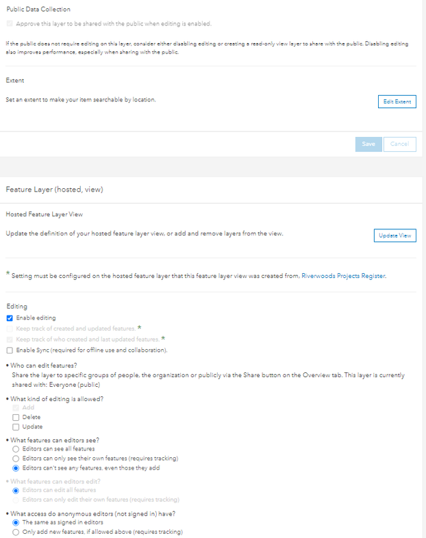

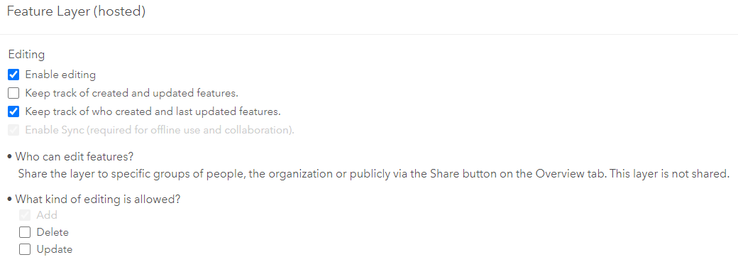

Solved! Will leave this in case anyone has a similar issue but the above 'Feature Layer' settings needed updating on the 'Feature Layer (hosted, view)' layers as well, which the submission url uses. Once I updated the settings here the submissions went through.

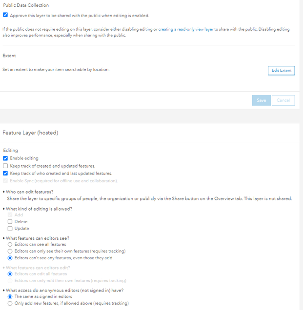

Sure here are the settings I have:
Hosted Feature Layer (Sharing level: owner)
Hosted Feature Layer, View (Sharing level: public)
As a quick note I actually ended up having two view layers. The second one doesn't have 'Enable editing' and this is the one I use on the webmap as I'd already set it up before finding the article. The one above is the one created by following the article which is used for the actual collection.

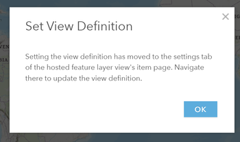

I then had some screening settings in the Visulization tab under 'Set View Definition' but it looks like this has moved... so that's a bit annoying, though what was previously set up is still working.
