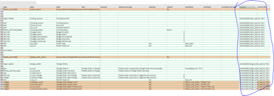

  • I've attached a screenshot of the error and the XLS form used for the survey

Zachary - i solved it. I needed to populate the Relevant field for the repeats.
DrewMoffitt
This did the trick! Like your example, I had to populate the relevant fields for ALL the fields within the repeats, and not just the repeats like I had.
