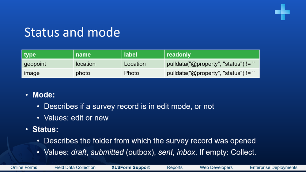

  • For line 34, you may want to use pulldata("@property",'status').
