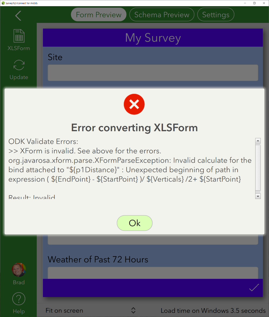

Trying to use Survey123 XLSForm to do a calucation based on a  few fields inside the form.  I keep getting this error.  I have all the bind:esrifieldtype set to double.  the syntax for the p1distance field for the calculation is
(${EndPoint}-${StartPoint})/${Verticals}/2+${StartPoint}
Any help would be awesome!

Hi Brad,
A couple of things
- you may want to set the bind::type column of the calculate questions to ensure they have the appropriate data type while processing inside the form
- '/' is not the proper indicator for division in XLSForms; the appropriate keyword is 'div'

The problem is that the ${Verticals} question is a text question (by default all select one are text type even if they contain numeric values). You need to set the bind::type as int or decimal (depending on your numeric values in the field) and also in your calculation in ${p1 Distance} you can cast the values as int also.

THANKS  With a combination of these posts I got it
