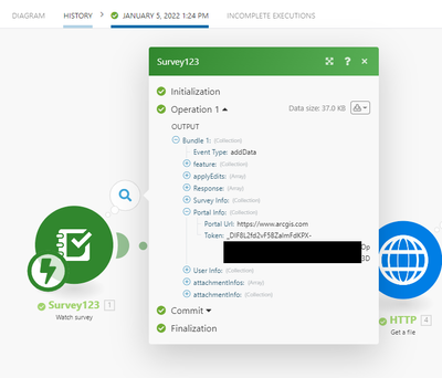

If the feature layer is secured, I'm assuming the submission is from a named user account and not anonymous?  You can grab the token right from the watch webhook module in integromat:

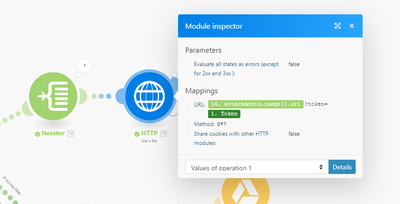

To download the photo, add   ?token=[token] to the end of the image URL
This example is downloading attachments (in a repeat) via an iterator and then uploading them to google drive.  I believe you can add them to an email one by one as well, but I haven't tried that.
