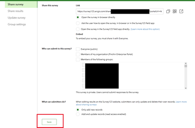

Can you confirm that the account you used in Connect to publish the survey is the same account that you are logged into the S123 Field App as?
Once you do that, delete the survey from your S123 Field App (mainly to ensure that we A) have the proper survey, and B) that nothing odd is going on with the survey -- sometimes the survey in the field app can act up and this is the easiest solution).
Then, go to the S123 website, reset the permissions for the survey, and then Save them (do this even if everything appears to be correct).
Then, re-add the survey from the website to your Field App (or do so directly from the field app).
CN3
Yes, the account that I use to log in on my phone and desktop are identical.  I have no other ArcGIS account.
I'm running the latest version 3.19.120 of the My Survey123 app on my phone.
I deleted the survey from the app.  When I try to re-add the survey, I get the "Error unpacking" message.
I can't access the screen you show above.  I can't view anything about the survey in Survey123.  I keep getting the error message. I only can view the tile.  Clicking on anything to go further prompts the error message.
