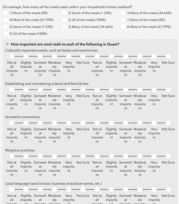

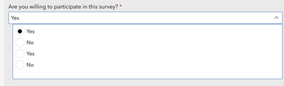

Example screenshots below... Error occurs within multiple view styles of select_one select_multiple questions.
PGGIS_0-1670360724324.pngPGGIS_0-1670360724324.pngPGGIS_1-1670360734491.pngPGGIS_1-1670360734491.png

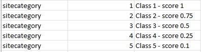

Seems to only affect select_one questions that are numeric. Example:
Creating an external choice list (select_one_from_file) works as a workaround.

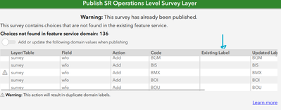

This is occurring with a form we made ~4 years ago. Its operational, so I really don't want to break it (especially since double answers could effect the data I would think). I am kind of at a loss, we have been making copies of the form and trying to recreate the warning but the copies I make are fine and publish smoothly. What is really weird too is that the existing label column its comparing against has no data in it (see image). I want to chalk it up to version updates and stuff but the copy I made works just fine if I don't update it to the newest version or if I do. If anyone has suggestions of a fix that will honor the survey's existing FL connections and data I am all ears

Your issue is likely different from what's described here since you are seeing this warning:
The bug described here is more of a "visual" bug that results in 2 (or sometimes 3, 4, 5, etc.) copies of list items.
I'd suggest making a new post (and potentially including your XLSX).
