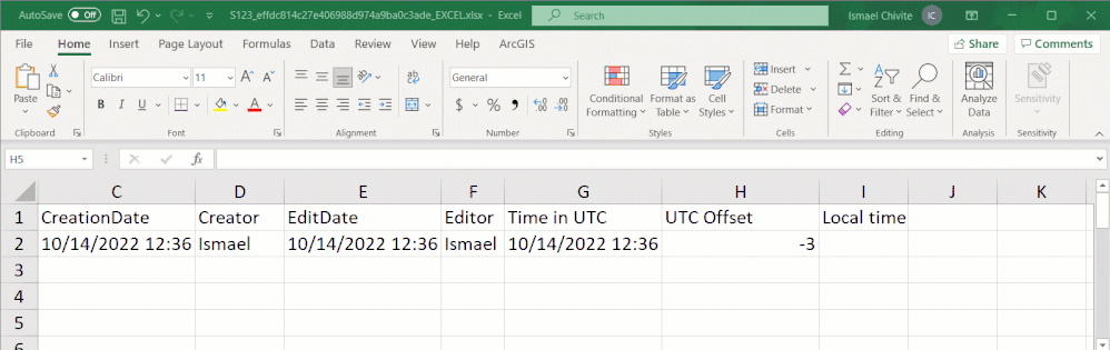

You can convert UTC dates to your local time in Excel. Check this out https://excel.tips.net/T003440_Converting_UTC_Times_to_Local_Times.html
Say for example, you want to convert UTC time to Los Angeles time, which is at UTC offset -7. You would do this:
Survey123 allows you to store the UTC Offset at the location where data is being collected. This can be useful too in some scenarios. Here is how you can configure your survey to collect the UTC offset of the respondent:
If you do the above, Survey123 will store the UTC offset in a column. You can use that UTC offset in your Excel formula.  Say for example, you ask someone to enter the time when a business closes.  People from Florida enter 8:00pm.  People from Los Angeles enter 8:00pm... but when you get the data from ArcGIS... you get UTC values! Messy.   If you have the UTC offset of the respondent, you can always get back their local time. I hope it makes sense.
