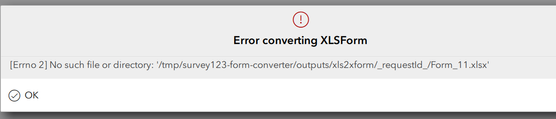

I tried your form but I get this weird error
Nihe_N8
Hmm, not sure why you get that error. Can you try again with the forms below please - I looked over it and there were a couple of question types I'd added while testing which I've removed as they aren't needed. Thank you.
