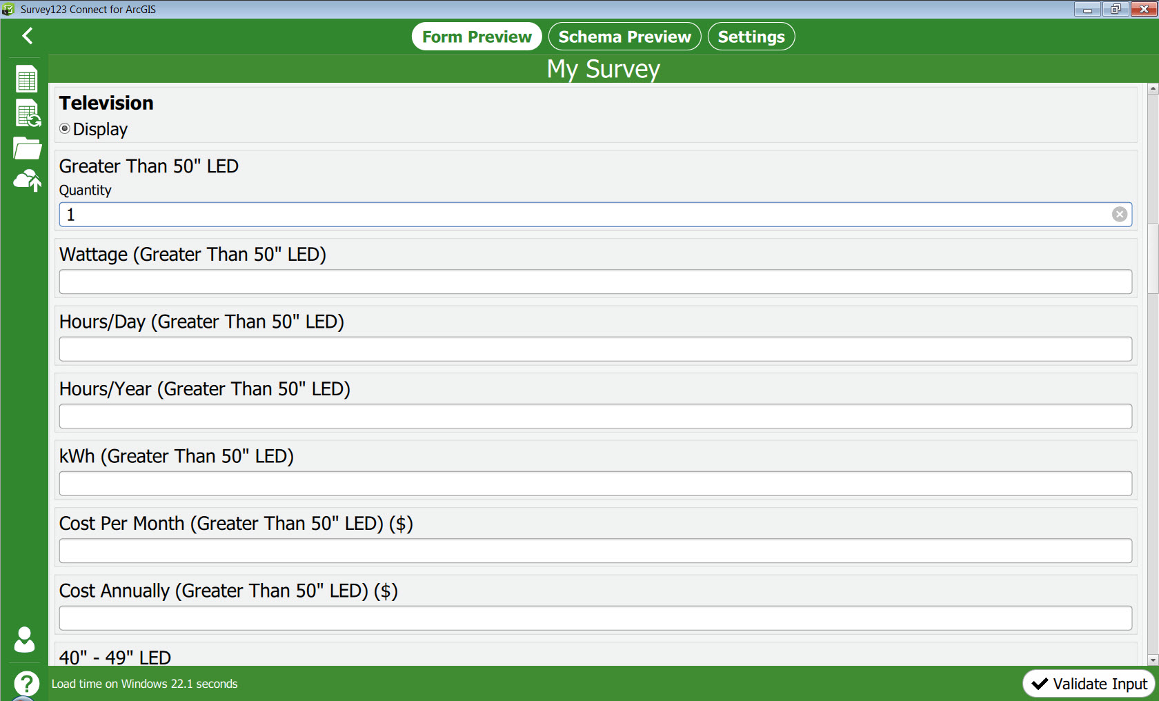

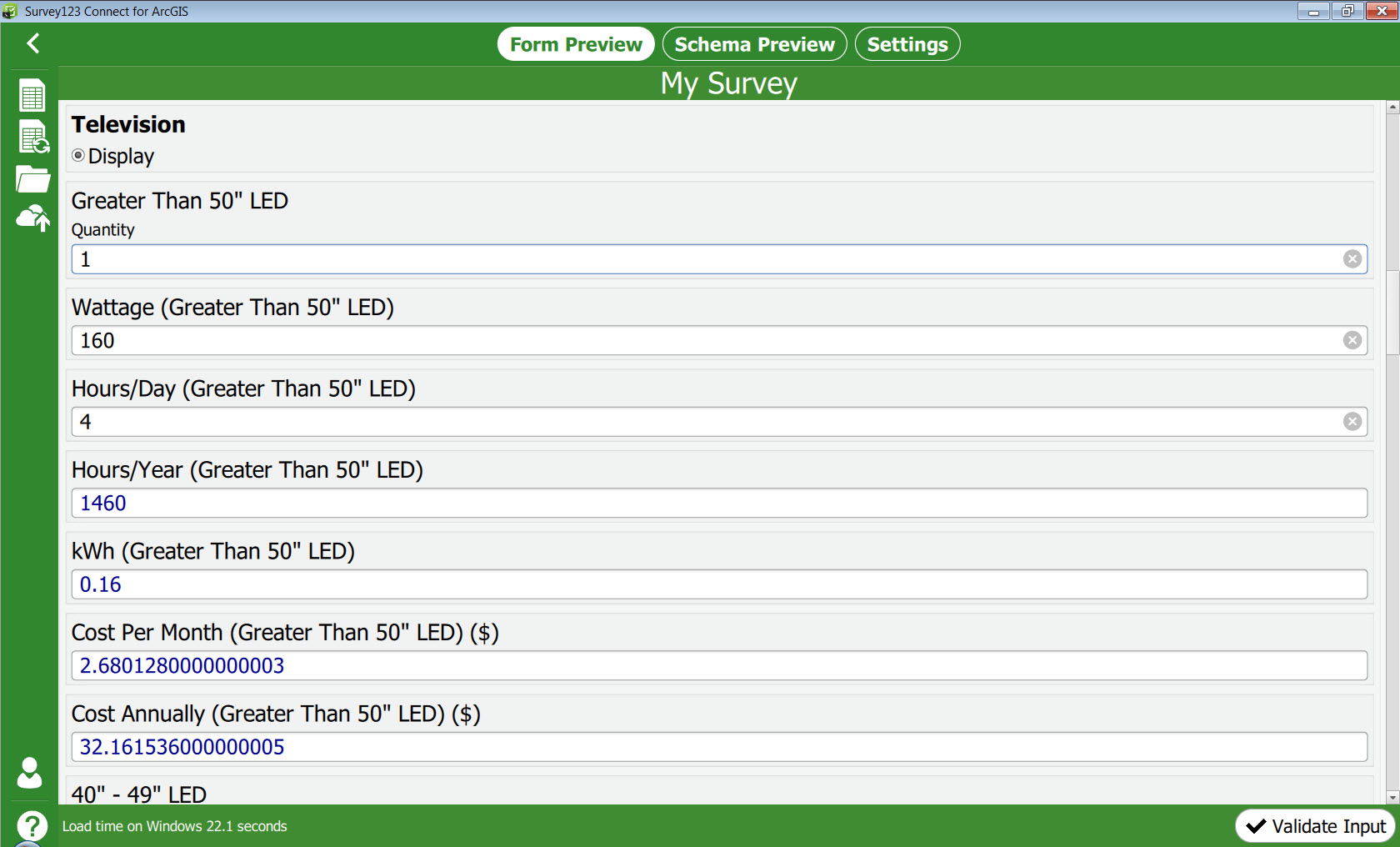

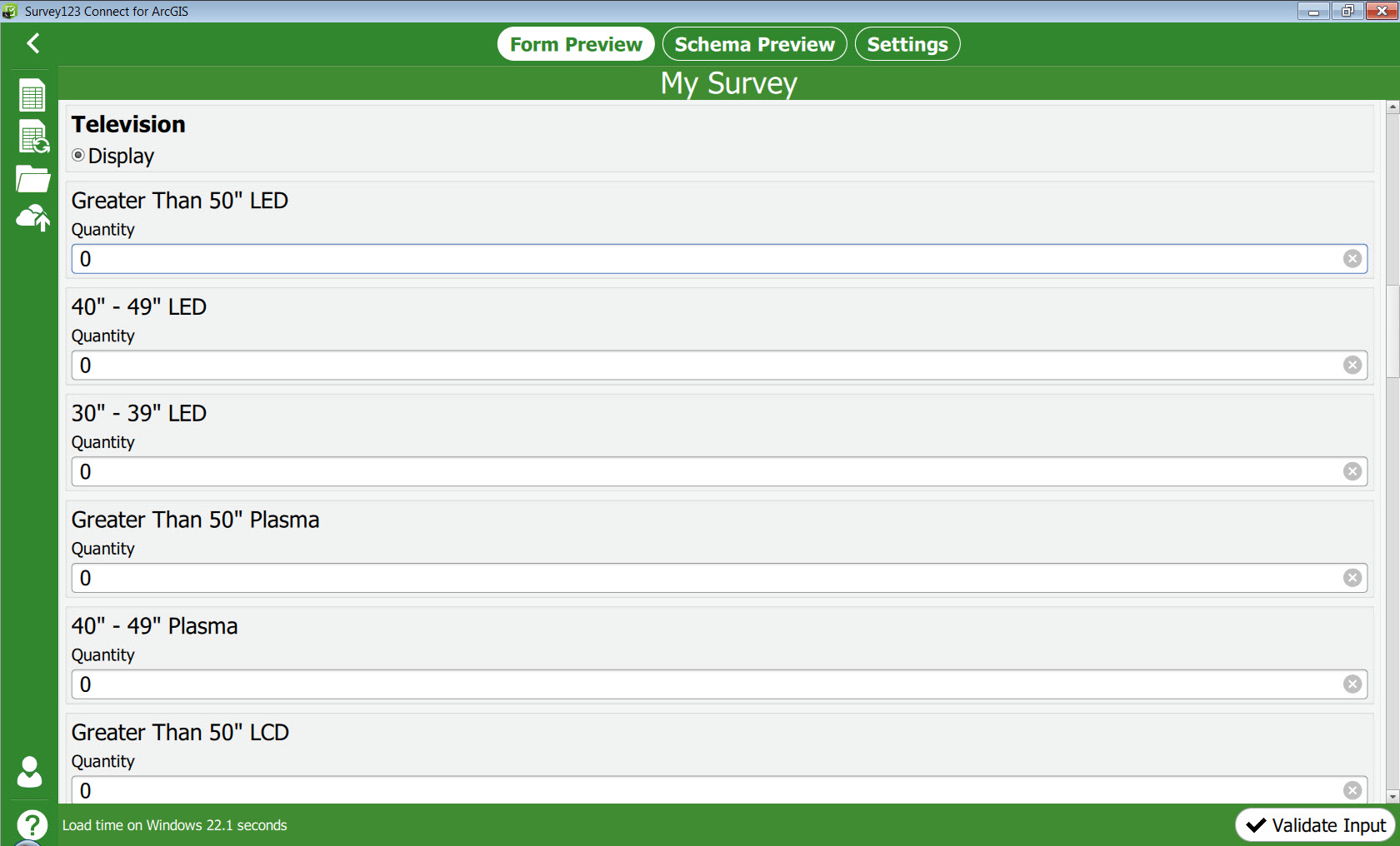

A survey has been created and anytime the following steps have been performed the quantities get removed:
Configuration of form:
Step 1:
Input quantity under 'Quantity' field (value greater than or equal to 1).
Step 2:
Update input quantity to Zero under 'Quantity' field.
Step 3:
Update input quantity to greater than or equal to 1 under 'Quantity' field.
Error: Values under fields named, Wattage, Hours/Day, Hours/Years, kWh, Cost Per Month and Cost Annually get removed. Values do not get regenerated.

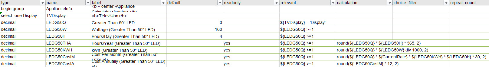

Hi Francisco,
What you're experiencing is an interplay between default and relevancy.  As you might expect, a default value is only assigned when the form is created.  When a question goes from relevant to not relevant (i.e., not displayed), the answer for that question is removed; this is to ensure we don't save answers to questions that, according to the form's logic, haven't been asked.
As a workaround, instead of supplying a default value, we can use a calculation that uses the same statement as your relevant clause in an if statement to calculate in the default value - see attached.

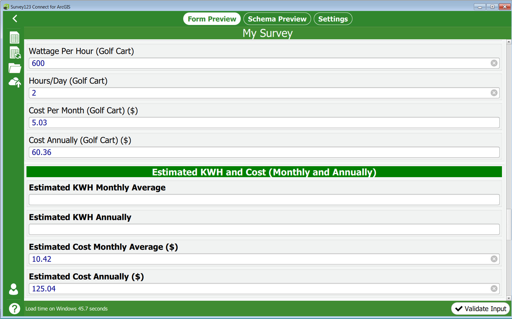

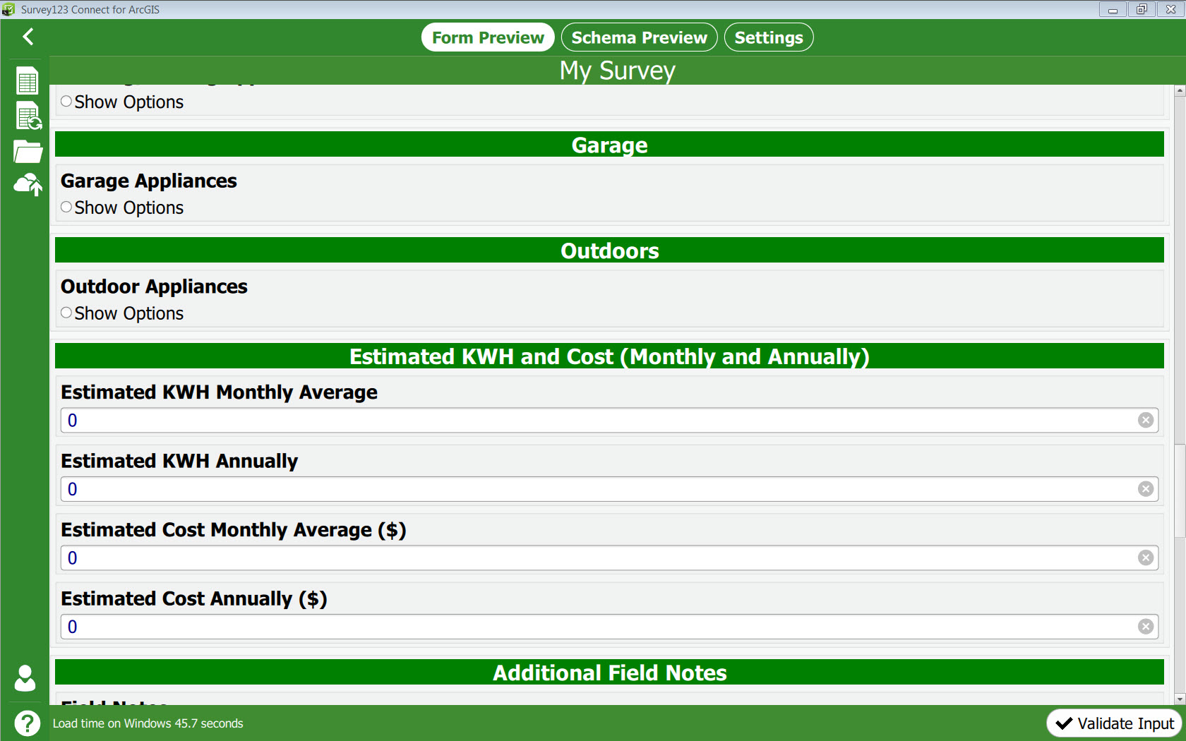

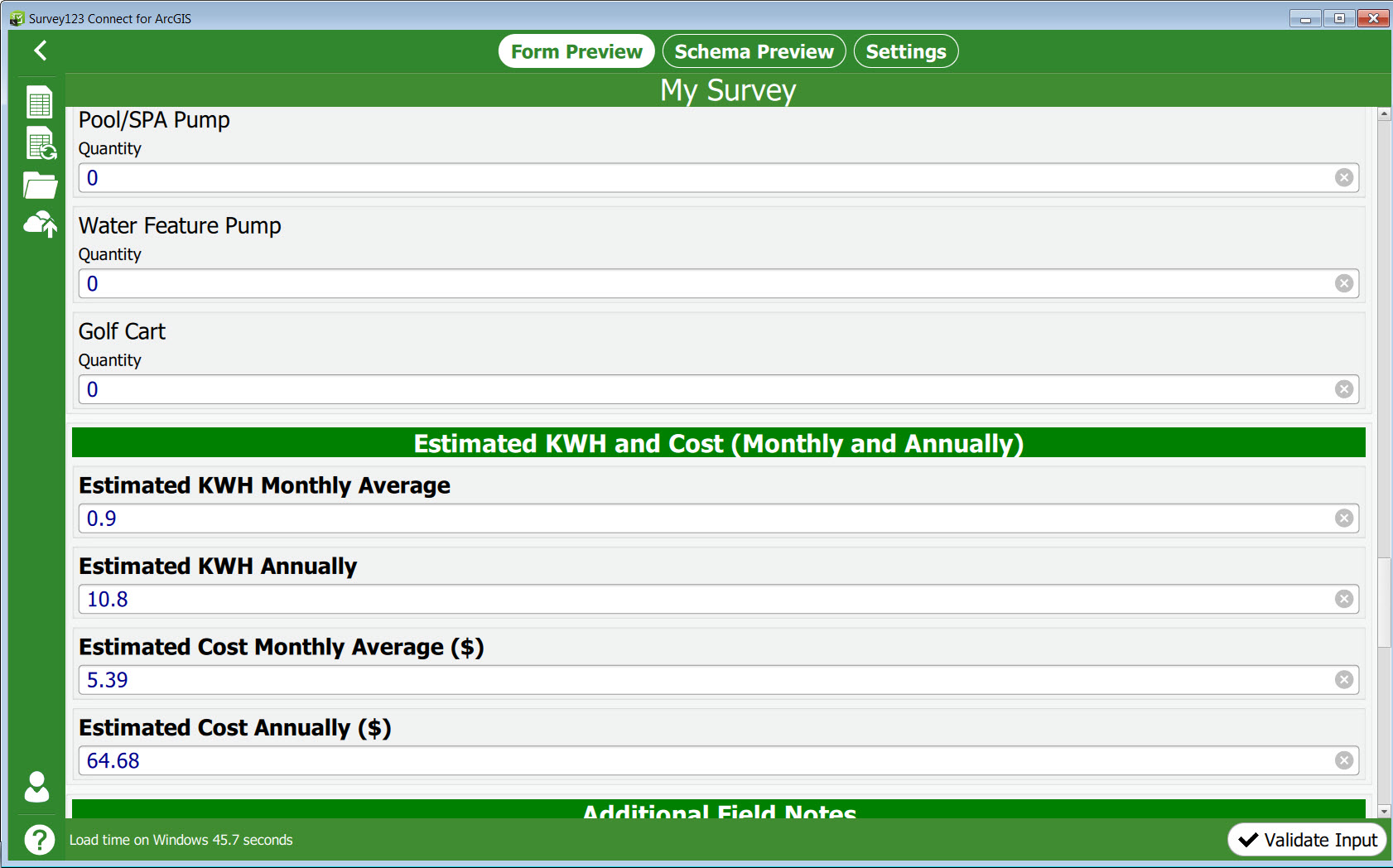

James Tedrick‌ I am having an issue again with the survey123. See issue below.
Step 1: The survey is loaded and fields named Estimated KWH Monthly Average and Estimated KWH Annually have a value entered 'zero'.
Step 2: A value is entered in field name Water Pump (Quantity). Values for Estimated KWH Monthly Average and Estimated KWH Annually are updated.
Step 3: A value is entered in field name Pool/Spa Pump (Quantity). Values for Estimated KWH Monthly Average and Estimated KWH Annually are removed.

Hi,
The issue of the summarization is that you summarizing hidden fields - by default, hidden fields are stored as text.  You need to convert to decimal either by supplying a bind::type column or using the number function.  See the EnergyUsage.xlsx
