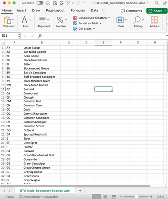

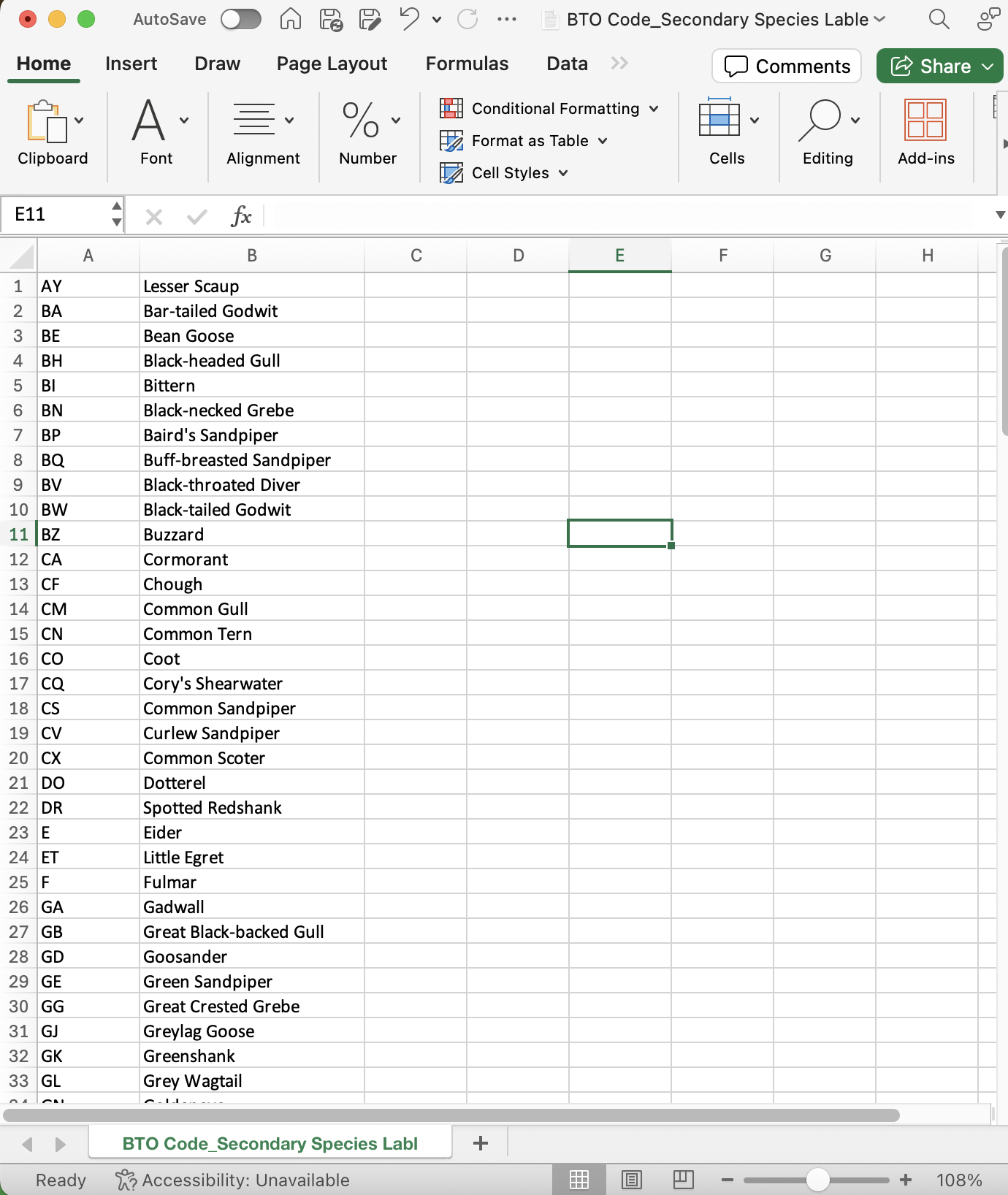

I have several lists of coded features (e.g. bird species codes; please see screenshot below) which I want to apply to drop down menus in Survey123 web app to collect data in the field app. I would like to create a dropdown menu which will autopopulate the name in the next field in Survey123 field app.

I am currently working off macOS so don't have access to Survey123 Connect (having a new machine delivered next week). Is there any way this can be done in Survey123 Online?
