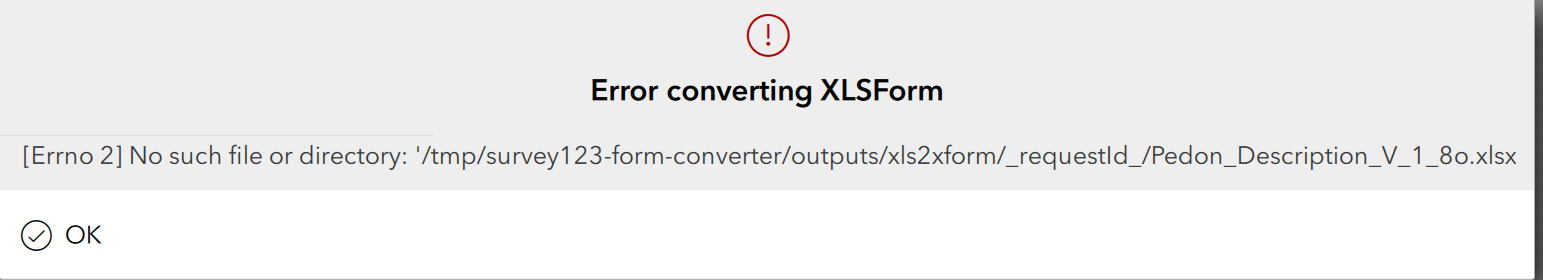

I just started using version 3.15 Survey123 Connect. I keep getting various errors that the *xlsx.xml doesn't exist. I tried it on 2 different computers for version 3.15. The issue pops up when I edit current forms and when I create new forms. I have not moved any files.  Any ideas what the issue might be? Thanks.
1st Example:
2nd Example:

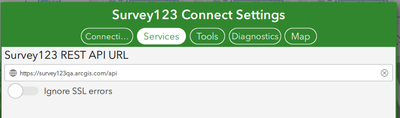

We do have a fix for this issue coming with our 3.17 release later this month. For the time being if you change your API URL in Connect to https://survey123qa.arcgis.com/api that environment has the fix on it at this time.
To change the API URL in Connect select the profile icon or hamburger on the top right and select Settings. Select the Services and add the qa after survey123 in the URL:
It is recommended that after Survey123 3.17 releases you switch the API URL back to the original https://survey123.arcgis.com/api.
