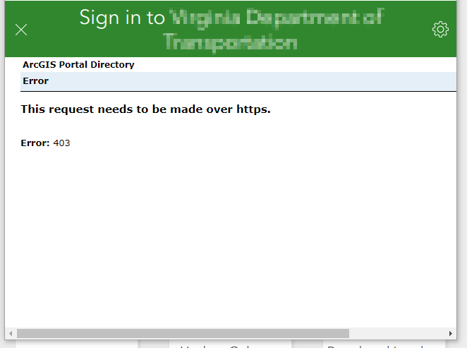

I once connected my Survey123 Connect to a portal.  Since then, I am unable to log on Survey123 Connect any longer.  I removed all other portals from the "Portal" setting and only arcgis online is left.  However, whenever I open the sign in window, it shows the portal connection error.  I tried removing the software and installing a new version, clearing Internet browser cache, but nothing has worked so far.

Hi Ahjung,
What version of Survey123 Connect are you using and on what OS and version? Are you able to use the field app to connect to the Portal or Online without the error?
When you added the Portal did you use http or https? We only support https so can you please add the Portal using a https address and try again?
Phil.
