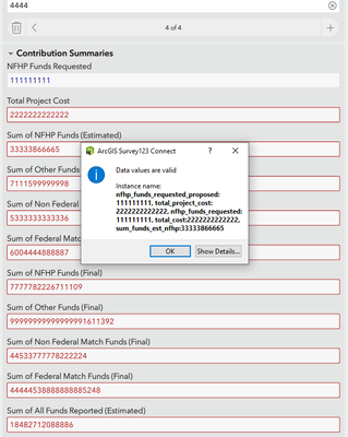

I have four fields that calculate the sum of repeats (related to the amount of funding). I want to calculate the sum of all of the summed repeats, however, when I use the following calculation, nothing appears in the field (I have tried two options and neither work):
option 1: ${sum_funds_est_nfhp}+${sum_funds_est_other}+${sum_funds_est_match_nonfed}+${sum_funds_est_match_fed}
option 2: int(${sum_funds_est_nfhp})+int(${sum_funds_est_other})+int(${sum_funds_est_match_nonfed})+int(${sum_funds_est_match_fed})

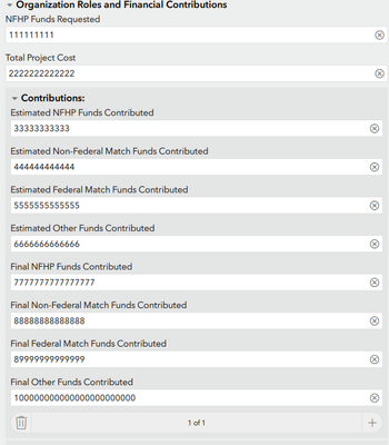

I've attached the group with the repeats for reference.
Thanks!

Why did you only attach the survey tab? It requires more effort than uploading the entire XLSX sheet and the only way contributors can even try to replicate the problem is to delete all your constraints or rewrite all the other tabs and all your choice lists.
I'm not going to rewrite the material, so I have just deleted all the constraints, and that works perfectly. That suggests that the problem is being caused by the constraints.
