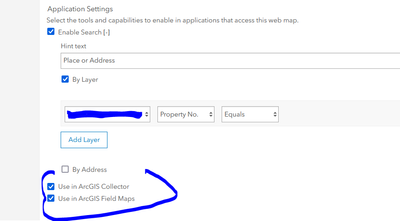

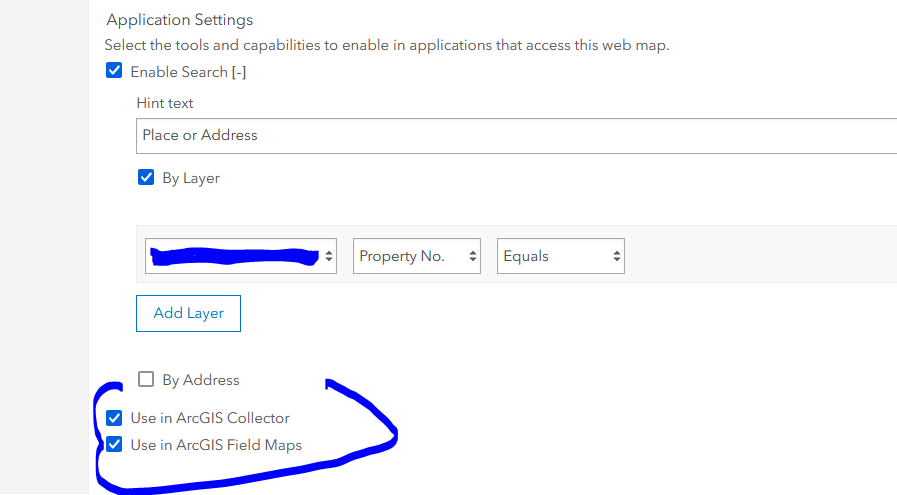

I set up a search in map by layer and I would like the user to search for a particular property in case he is filling the survey when not on site.
It is already set up and the only thing i see is the address, which is disabled in my settings.
(then I read "use in ArcGIS Collector" "use in  ArcGIS Field Maps" only.
If not possible, would  the search at polygon work by typing a property number and the point on map is created?
Thanks!

Can you clarify your workflow? Post is about field maps but you've put it on the Survey123 board.
Assuming you are using Field Maps and want to search for a polygon in the map, which would then launch a survey form from the pop-up:
  • Go to the map > item details > settings
  • add layers and fields to map search settings
However I can see you've already done this for the map. So in field maps you should be fine to search for property numbers on this map. This won't impact survey123 at all, just the web map and applications that leverage the map.
If you are filling out the survey form directly you could use the search appearance to find existing property numbers and then use pulldata @ layer to get related data including location.
