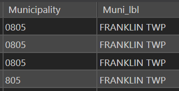

We are experiencing the same issue after the Feb 25 field app update, despite the field type being set to string. Any workarounds, @JamesTedrick@IsmaelChivite? Thanks, guys!!
GianniCampanile2
We have the same problem too: leading 0 are stripped both from choices lists or from pulldata values. Version 3.11 is fine, version 3.12.244 and 277 have this bug. Even if you define text values in Excel, of using the ' sign to force text it does not work  (and in any case it could not work for pulldata).
