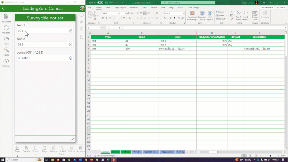

@RM_-_AmyOrtner__GISS_  It would be great if you can share an XLSForm to illustrate the problem. I created my own XLSForm based on your description and I do not lose any leading zeroes.
Attaching animation with the behavior I see and the XLSForm I used.

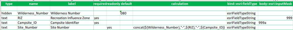

AOrtner
Ismael, shortly after posting my problem with the leading zeros, I found a way to make it work. I'm not sure exactly what I changed, I think it may have been defining the field type as string, but it has been working. Here is what the xlsx looks like now.
